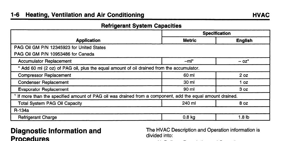

Your system is supposed to have 1.8lbs (28.8 ounces, or at least my 02 is). I just fixed mine, and I thought I remember getting about 30/ 260

You could have too much oil in the system. If you do, It will effect the pressure and the cooling temp.
When I changed the condenser out, I added the recommended amount back to the system and it will cool to the point that the vents blow frost out and eventually freeze up the evap core. The suction side hovers around 25psi on a 95 degree day which if I remember right should be cycling off at about 28psi.
I’ll be evac’ing the system to flush the lines, change the orifice tube and then start checking all my low pressure wiring circuit. When I do this, I’ll need to add oil and I’m not really sure how much to add back in at that point

Old Jun 25, 2022 | 02:38 PM

Originally Posted by adriver
thanks for that and your numbers from charging
