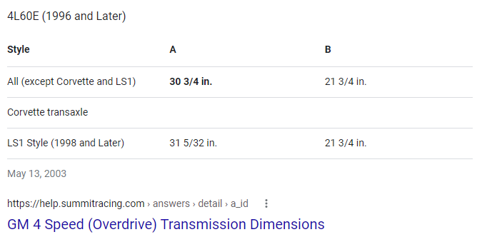

From what I was seeing the 6L and 4L are damn near the same overall length. In fact If this info on Google is correct. the 6L is actually shorter...SO the shaft might be reusable if it has the right splined end.
