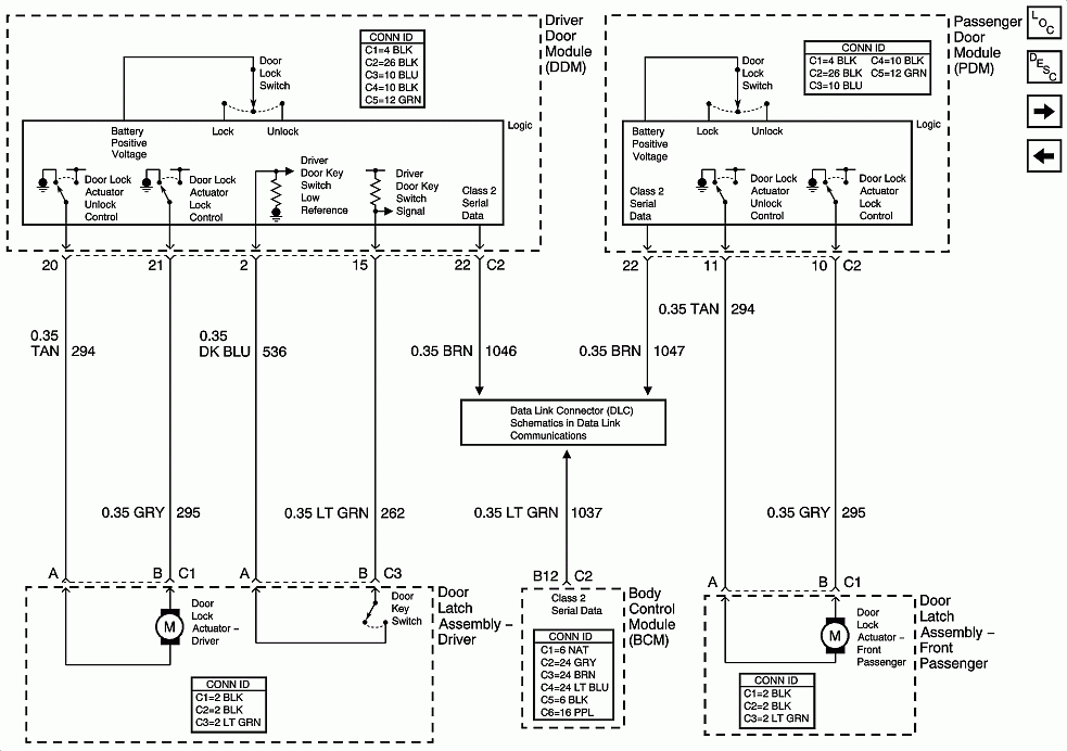

bullygoat's Avatar
Joined: Sep 2004
Posts: 174
Here's the wiring diagrams for the drivers door lock. One other thing, it could also be is the driver door module causing the problem also.
