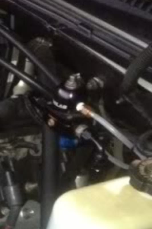

I've had my fuel lab FPR for 3 yrs without a problem , so I can def recommend it. It's mounted on my firewall and with a couple of fitting adapters was easily plumbed into the NNBS fuel rail and stock return line .
Old pic but you get the point

I was told when I was doing my fuel setup on my RX7 (Aeromotive FPR) that NHRA doesn't allow FPRs mounted on the firewall in case something in the bellhousing blows. Have you had any trouble with tech inspection at the strip?

Looks great, I will definitely check out Fuel Lab's products.
