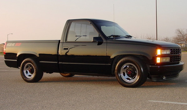

The old 454SS trucks came with that size tire stock, on a 7" wheel. BFG's have always seemed a little wider than other brands of the same tire, but that is what GM thought was a good match of wheel and tire back in the day...
