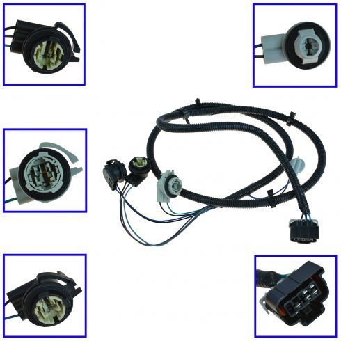

Cool- thanks for all the input- can someone show me what this harness looks like or where I can get one? Don't wanna freak the computer out........
I think I found what I'm looking for....
If this is it, not a problem, then.....

The second picture in the ad shows wiring harness and bulbs.

I bought these same ones for my 2000. They include everything needed including harness, bulbs, harness and great instructions on how to hook them up in 99-02 trucks.
