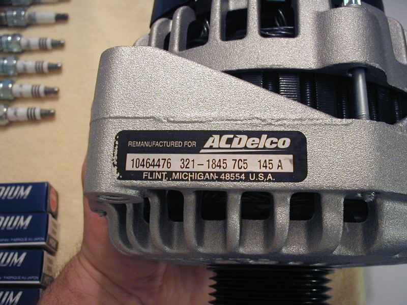

I've heard that when you upgrade the alternator (in my case from a 105A to a 145A) that you should upgrade the alternator wire. Is this necessary, and if so, what needs to be done?

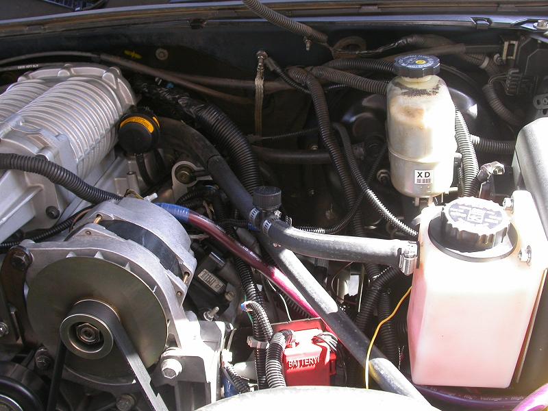

I went overkill on my 200 amp alt and did 1/0 gauge direct from alt to battery +
Attached Thumbnails Swapping out alternators....need wire upgrade?-dscn1238.jpg

LOL...I have yet to see my voltage drop or headlights dim from the stereo, and I have 3 amps with 2400 watts RMS. Overkill =
I also upgraded the battery to chassis ground and engine block to chassis ground wires to 1/0 guage as well.
