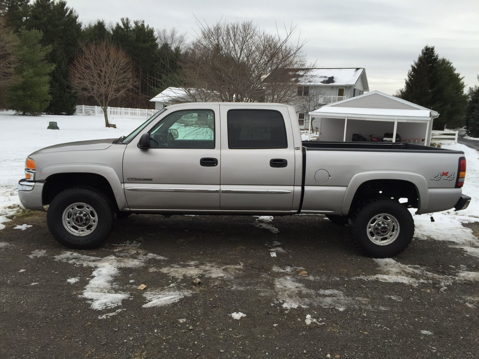

Yeah I tried earlier. Lemme see

Or did you mean how the truck sits?
As far as I know it's stock suspension with the keys maxed out

The day I bought it

Thats not stock height.

Well I just did wheel bearings up front and nothing didn't look oem especially cuz the ball joints are wore out... Think they just jacked up the back? maybe I got lucky and only gotta do the shocks in the rear haha... Probably explains why it rides like **** right now, and why it's super easy to lose traction... All I have ATM is an intake, and I own HP tuners (not a newbie) so it got tuned day one...

Yea I would say they simply did blocks and cranked the T bars.
Lowering it down up front will help with ride quality for sure. I would guess you can find stock blocks for dirt cheap somewhere...
