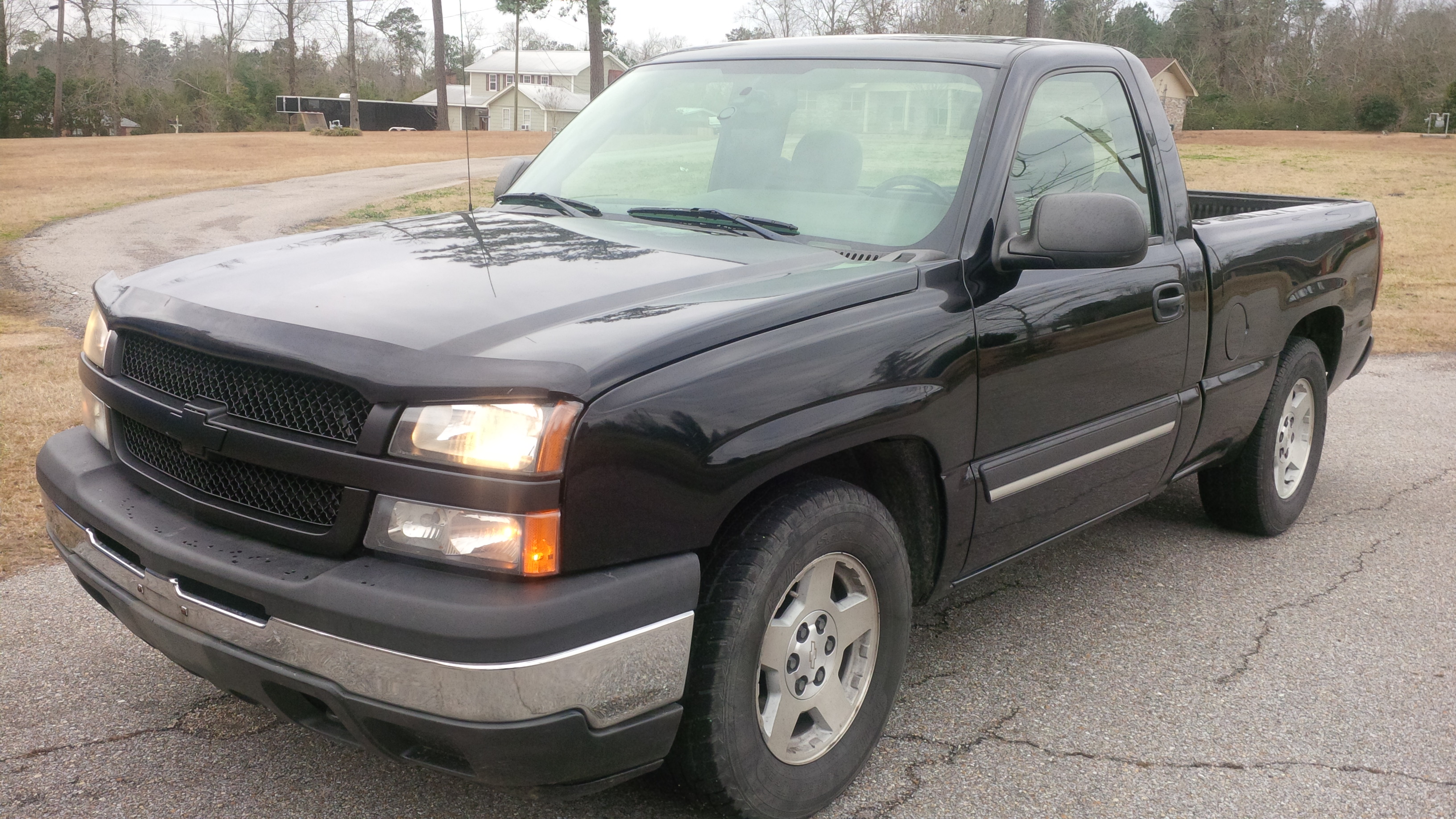

Finding a decent RCSB is hard, at least for a decent price. Some people think these things are made of gold or something. I've seen 99-01 models go for 6-7k. Seems a bit much to me for a 3k truck. I searched a while and found a loaded 05 that needs a bit of TLC, but overall clean truck. Only paid 3k for it, it ran but the 4.8l engine was shot. But 5.3l engines are all over the place for cheap. I'd recommend getting a V8 truck to start. It's a lot cheaper in the long run to than swapping from the V6. I got under 4k in mine after swapping a low mileage 5.3, an almost new gm reman 4l60, a cam and valve spring upgrade, and all new gaskets. She runs good now. Still needs a good cleaning though.
