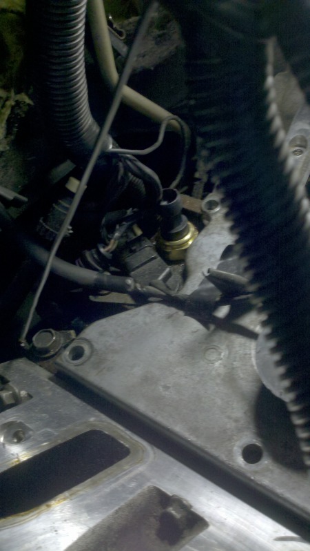

Where is the oil pressure sensor located on an 06 LM7 ?
Picture would help...Please !!
Old Sep 3, 2012 | 11:23 AM
fastnblu's Avatar
Joined: Mar 2008
Posts: 5,718

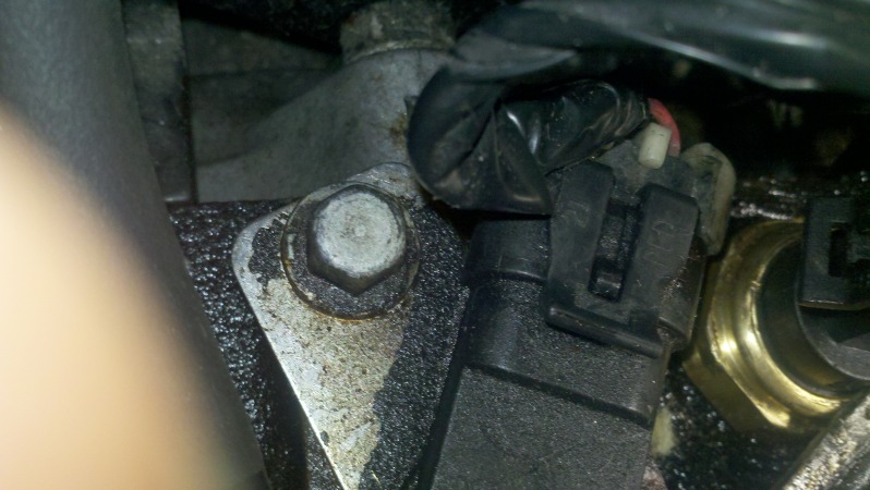

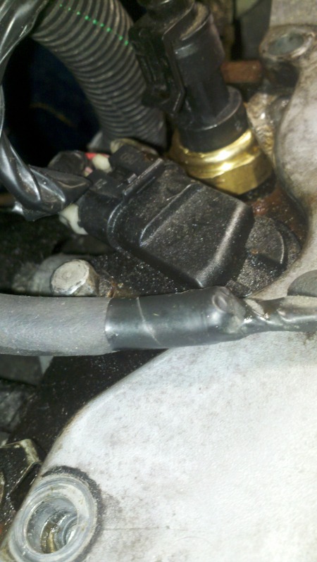

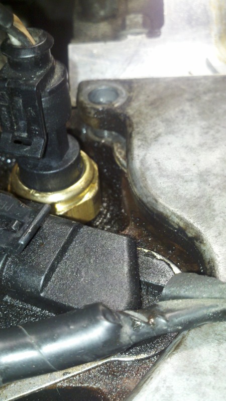

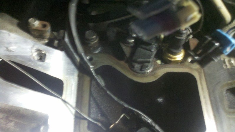

1 1/16" Skt, & it's on Rr of mani. at firewall. And it's tight, I assure u.

Not sure why this 1st pic won't jive, but the others will help u out. About $48 from NAPA, & u won't have the issus of valley pan gasket in the way on yours, but that's another story, so u don't have to worry there.
The culprit!!!
Not on your best day is it comin loose.
A better view why not.
I replaced it anyway. Cause I don't wanna go diggin back there again.
