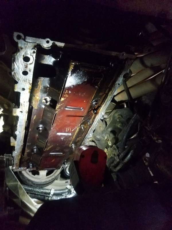

Today we started a tear down.
Oil pan leaking...check.
Rear main leaking...check
Rear cover leaking...check
Oring on pickup tube...super check! It was so brittle that when i tried to remove it it broke in half. I also could barely bend it and it would break.
I think i caught this just in time. I'll finish the truck either tomorrow or Monday. We just stopped for some family weekend activities. I'll report back once its back together.
Also if anyone is wondering on a 6" lifted truck you must pull the trans back to get the oil pan out...I pulled mine out anyways to do the rear main so. This motor has 221k...maybe I should have just swapped it...but it runs so great...I wanna see if I can make it hit 300k...also original trans too.
