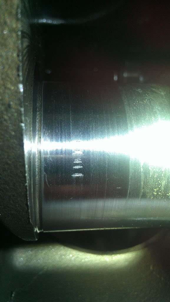

The question now is, how bent is too bent? I put in the bearings for 1 and 5, and turned the crank slowly with a drill so it stayed consistent. And to answer your question from earlier, the oil gallies were deburred.

Looks like you are measuring .001+ maybe .00125.
I believe you would be ok in that range.
Did you have long Oil galley brushes to clean the block prior to assembly??? 24-36 inches long???
Did you prime the engine by pressurising it with oil prior to cranking it???
What type of assembly lube did you use???

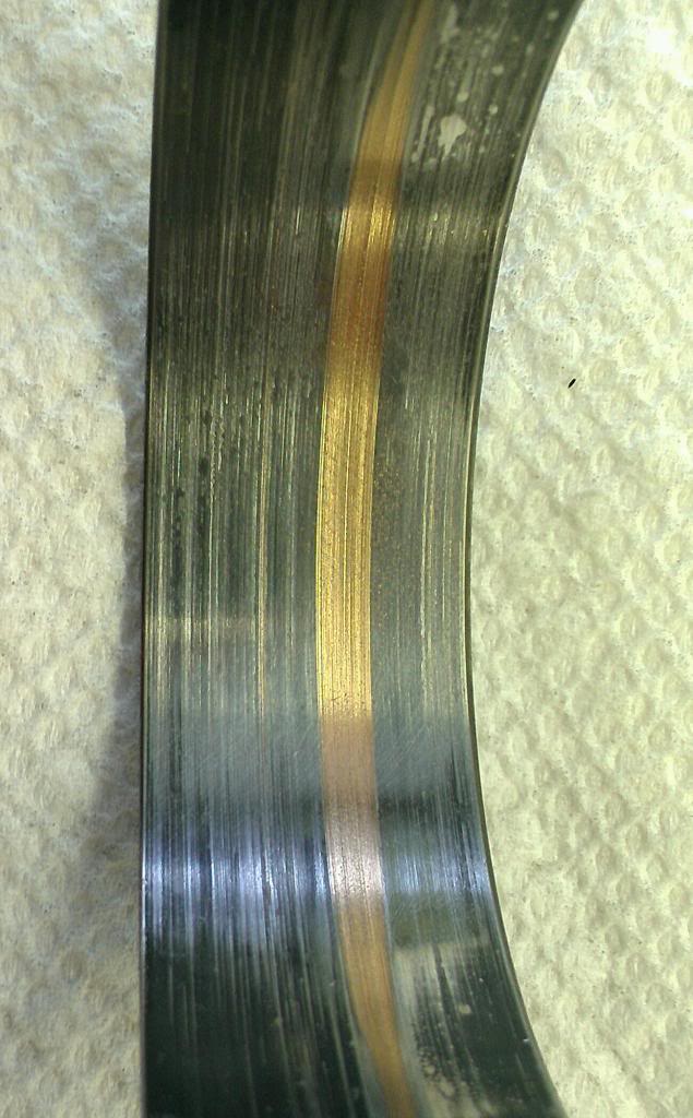

Well we are all here to learn, so I must say what I messed up. I put a nick in the crank during some part of the assembly. I didn't notice it, and that took out a bearing. Well then there was debris floating around the oil supply. This is not the first engine I have built, but this is the first time I have ever done this. I am still only making assumptions on how I did it. Thankfully I stopped it early and didn't cause more damage. I will more than likely be putting in an Eagle crank.
#56
Looks like it lines up with an oil galley hole.

When I first saw the bearing I thought it was debris trying to come out of the galley. When I turned the crank over I then saw the nicks. I will say I feel bad it happened, bit I am thankful I found the problem. I would have racked my brains out not knowing if it was resolved when putting it back together. I will have to look at my assembly lube to see what exactly it was. I know I got it from NAPA. I won't be touching it for a couple weeks though as I will be going on a well deserved vacation.
