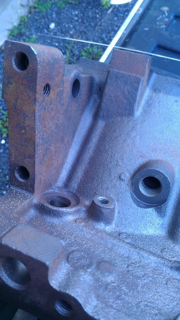

No, that doesn't sound harsh at all. You have always been very helpful to me on here. When I cleaned the oil pump, it was off the engine, and completely disassembled. After the machine work the pump was completely disassembled and cleaned with brake cleaner. I didn't think it would be a problem to use a pump over if it was cleaned. I cleaned all the gallies out with an engine cleaning brush. Sort of like a gun cleaning rod. I washed the block off with soapy water 3 times after pressure washing it off. I cleaned all nooks and crannies that I could find on the block. Every plug in the block was removed, and anything I could think of was cleaned and then some. I ended up using 4 cases of brake cleaner during my cleaning process. I was upset with my machine shop after getting the parts. My block was rusty. As my luck has it, the day my engine was ready, they had a small fire. Well my block got wet, and it sat for a month. It wasn't horrible, but wasn't great. That is why I went so overboard with cleaning it.

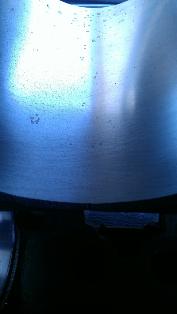

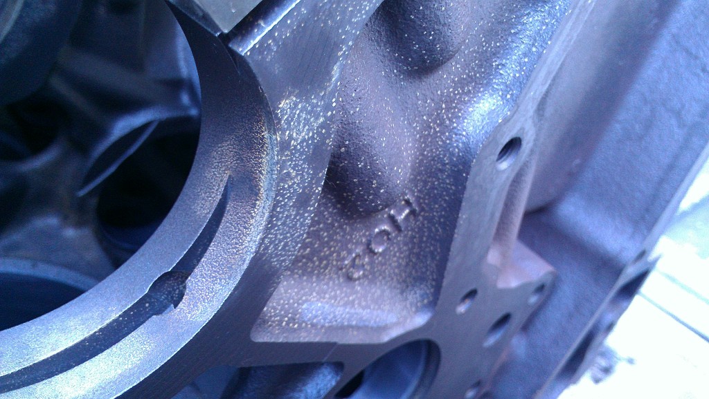

Here is what the block looked like the day I got it back. I was so upset I drove it to another machine shop that day and asked what I should do. He suggested I clean it real well.
