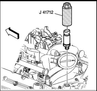

Old Dec 4, 2010 | 03:33 PM
tsduke03's Avatar
Joined: Mar 2010
Posts: 45
Top back of the block behind the intake.
