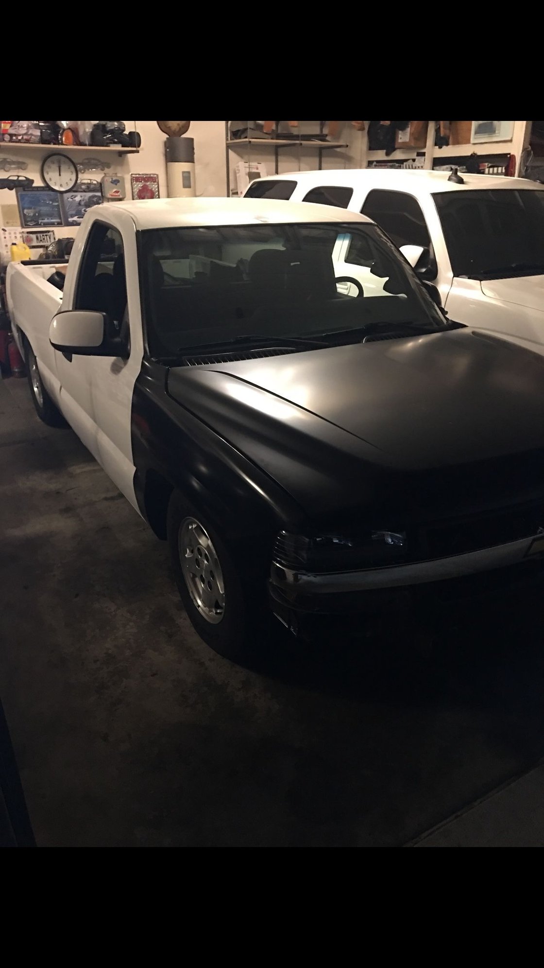

Hello all! New to the forums. Just bought my 2000 RCSB 5.3 Silverado today. Front clip is currently halfway done with the HD conversion (needs paint) and figured now would be the best time to add OEM fogs from the Z71 Tahoe. From what I have read all you need is the valance, fogs, OEM harness, cargo/fog button (currently just have cargo), relay and possibly a stealership re-program? Anyone have any experience with this? I was also interested in installing the 2003-2006 headlight switch with the option to disable the automatic headlights by turning it backwards (my 03 Yukon has this) and if anyone knows if this will all be plug and play it would be greatly appreciated! Thanks!
Also if this has been asked a million times I apologize... tried searching and couldn't find much detailed info on either the fogs or headlight switch.. but I could have been typing in the wrong keywords...
