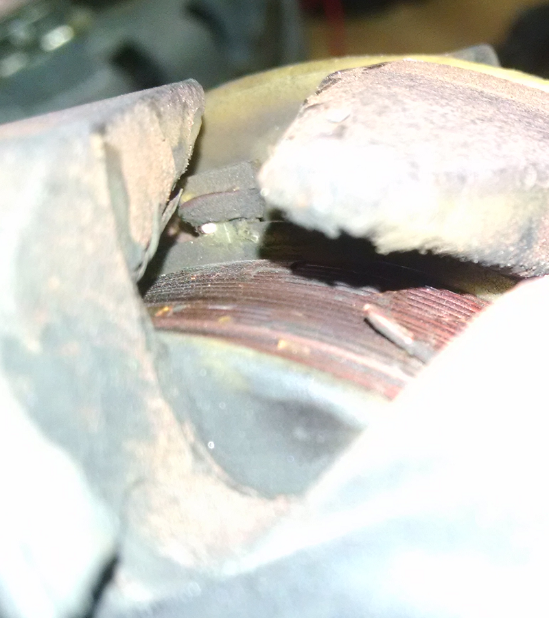

Fast forward to yesterday when I start trouble shooting the alternator. I ran all the tests presuming a bad voltage regulator or rectifier. Nope. I found no continuity thru the brushes so I presume bad brushes. Nope. Pulled the brushes off to get to the slip ring, no continuity thru the rotor. I completely disassemble the alternator to find a broken outer winding on the rotor as it wraps around the ear right out from the slip ring connection. I simply unwound one wrap of the winding, dogged it off on the ear and ran it up to the slip ring connection and soldered together. Reassembled, installed on the truck and seems to work better than before. I did a little internet research and evidently this is not a very common issue as I could not find a mention of it. I am just theorizing on what could have caused the failure where it was.

Pic of where the winding broke...

My guess is that a manufacturing flaw was introduced into the wire either from bad handling practices or damage during the production. It looks like a tooling mark -- the wire necks down to a thinner than normal diameter near the failure. Quite smoothly. Perhaps the smaller diameter wasn't durable enough to last the life of the product but strong enough to not break immediately.
