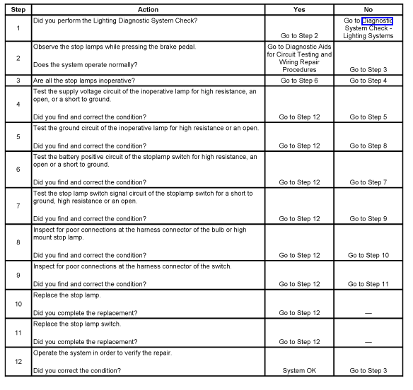

Try this. I'm on my phone. It's the first thing I found that I could view.
I would have to take the old one apart to show you and I am far to lazy right now...

glad i had my hand-dandy RPO decoder on the desktop (from looking at trucks for my wife)
here i was guessing JF4 was cruise... wrong! it's power pedals (neither of which i have anyway).
is this chart for a 99-02 or 03+? my plug has (A -> D) white, orange, purple, brown (last 2 swapped). does that even matter?

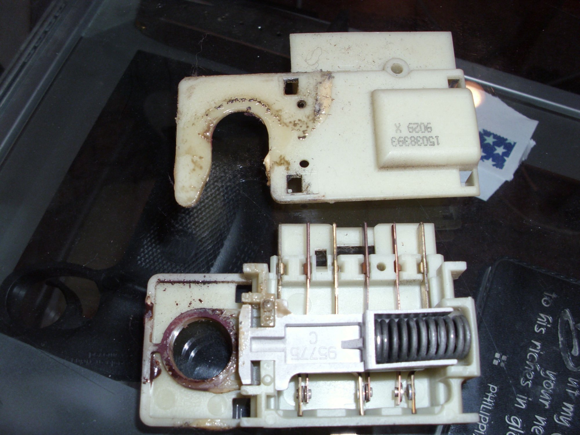

as for the switch, i opened it up & it's a spring loaded set of contacts (one normal-open, two normal-closed), so i'll just measure continuity across each pin pair.
i always forget i have a camera at home. forgive the mess... this is probably the first time in 20yrs it's been off the pedal.

That was a 2003 I believe. I haven't found one for a 99-02 truck but I believe it's the same. Just different colors.
Of course now that I say that I will definitely be wrong!
Yes, you have the right idea checking continuity

hmm... took it all apart & the contacts are clean, good continuity when it's supposed to, open when it's supposed to.
reckon, based on that chart, i'll just put on a rubber glove & stick a paperclip across pins A & B of the connector to see if the lights come on...
