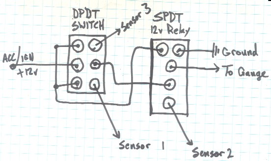

Here ya go, off-the-shelf stuff and any common DPDT switch will work, so easier to match interior.
Old May 24, 2009 | 01:21 AM
lq9crew's Avatar
Posts: 34
Thank You! Not what my schematic looked like in my head.
This one is much neater, and labeled much nicer! i appreciate the reply!!!
