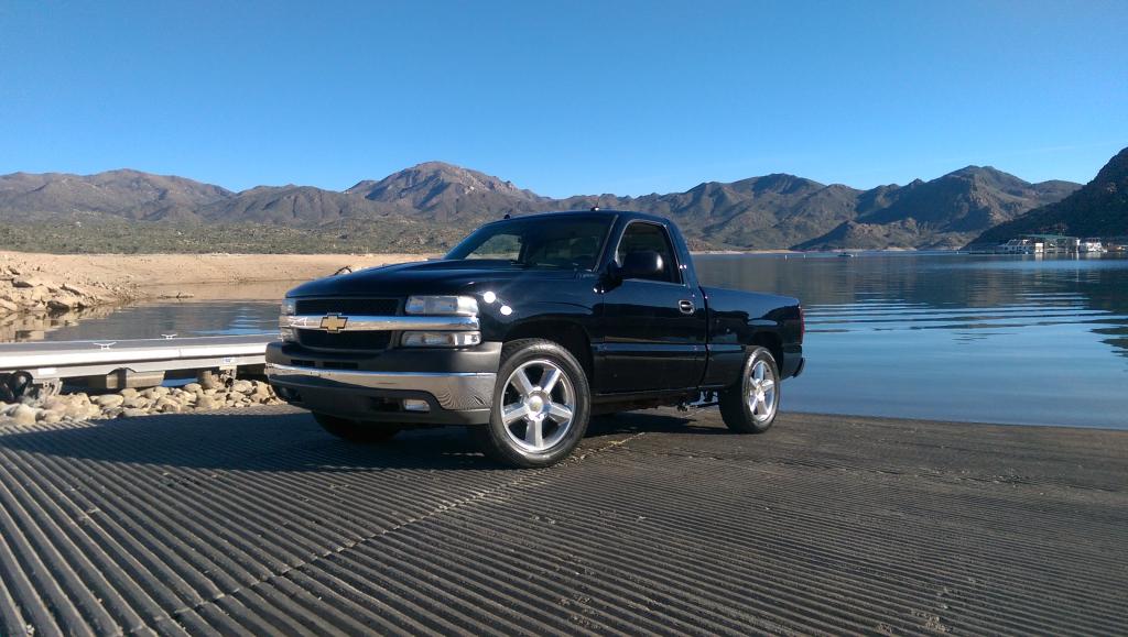

I have a 2/4 drop and ran 275/55's.

ffdp
are those the 275 55 in pic you posted?
2 inch shackles? anything to front?
if i can get fender well gap out of mine and it sets like that
im 100% happy with my truck
just afraid 275 55 is to big in front

Not saying I am repeating myself here, but I'll say it again once more.
Those pictures are with a 2/4 drop (spindles, hangers/shackles) with 275/55/20 Bridgestone Dueler Alenza tires.

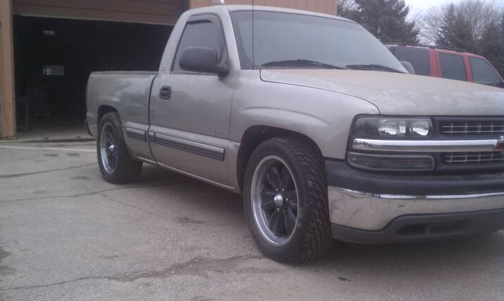

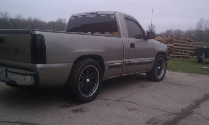

2/4 drop 295/45/20

The 295/45/20 is great size, too (I had these on the rear of my truck) But, you will need at least a 9.5" wide rim for that. I don't believe the LTZ rims are that wide.
