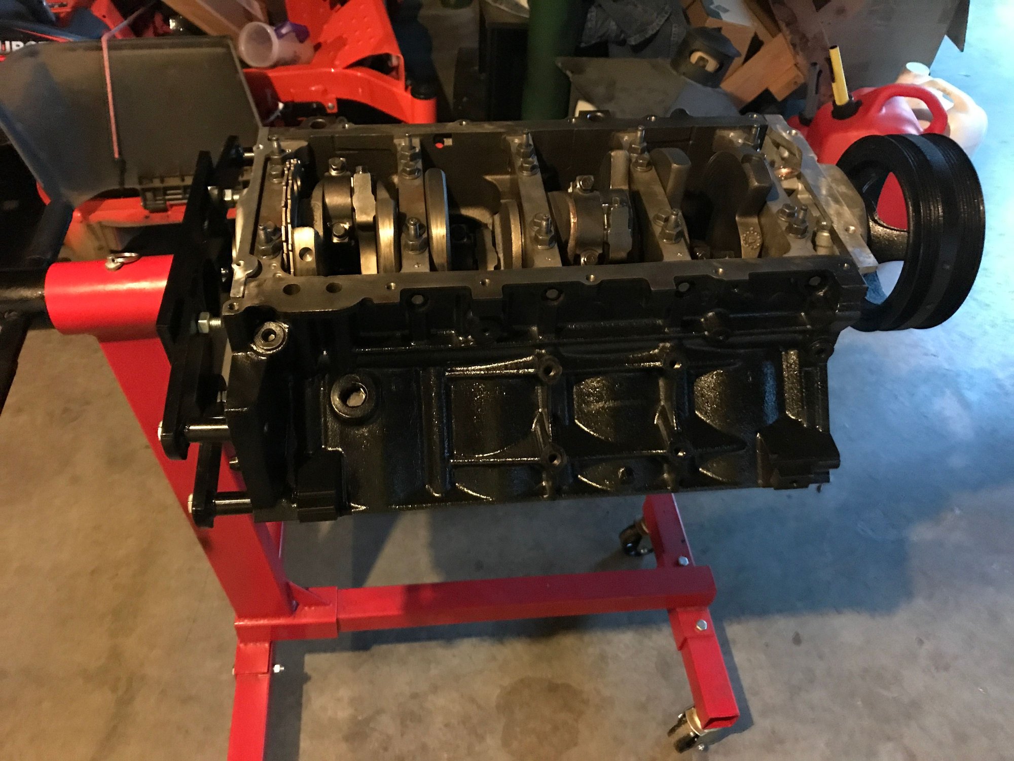

I need some tips and direction fellas.
I am building an 06 Sierra Denali
lq9 freshened up, all new bearings
220/224 cam
PAC springs
ls7 lifters
stock 317 heads
stock truck intake w/ 8.1 42lb/hr marine injectors
Tsp 1 7/8” LT
circle d 3200 stall
stock 4l65e w/ Vette servo and bigger tranny cooler.
4:10 rear end
around 5700 lbs with me in it.
In process of finishing build right now. Can’t wait to see what kind of numbers it puts out, but it won’t be enough I know. I want to have a truck fast enough to run with these straight pipe, EFI Live tuned diesels that fly by the house everyday.

Yeah, the mods sound good. Should make some real good power with a decent tune.
The only worries should be the stock drive shaft and the 4L60/65e transmission. Stock drive shafts are speed limited to 100mph, going over is just asking for it to explode at some point.
