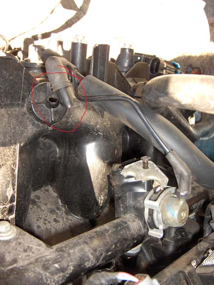

I noticed a broken part on my intake as I was finishing up my motor install yesterday. It is a small hose comming from the fuel rail on the drivers side. Can I glue this back on since it's a clean break or is a new part a must?

i'm not sure what thats for actually but if it clips on to the intake odds are it should just be replaced, if it's gas vapor it can eat the glue and make it seperate eventually, especially ifyou dont ahve high temp glue

ooo that is what gives the fuel pressure reg vacume. you might be able to get away with jb weld or something but i personaly would replace the intake. hot a huge issue but could cause some minor headaches that might be hard to diagnose like low fuel pressure or a vacume leak.

replace it

Is it possible to just replace the part that broke. There are several caps on the side of the intake. Do they screw off or are they permenantly fixed on?
