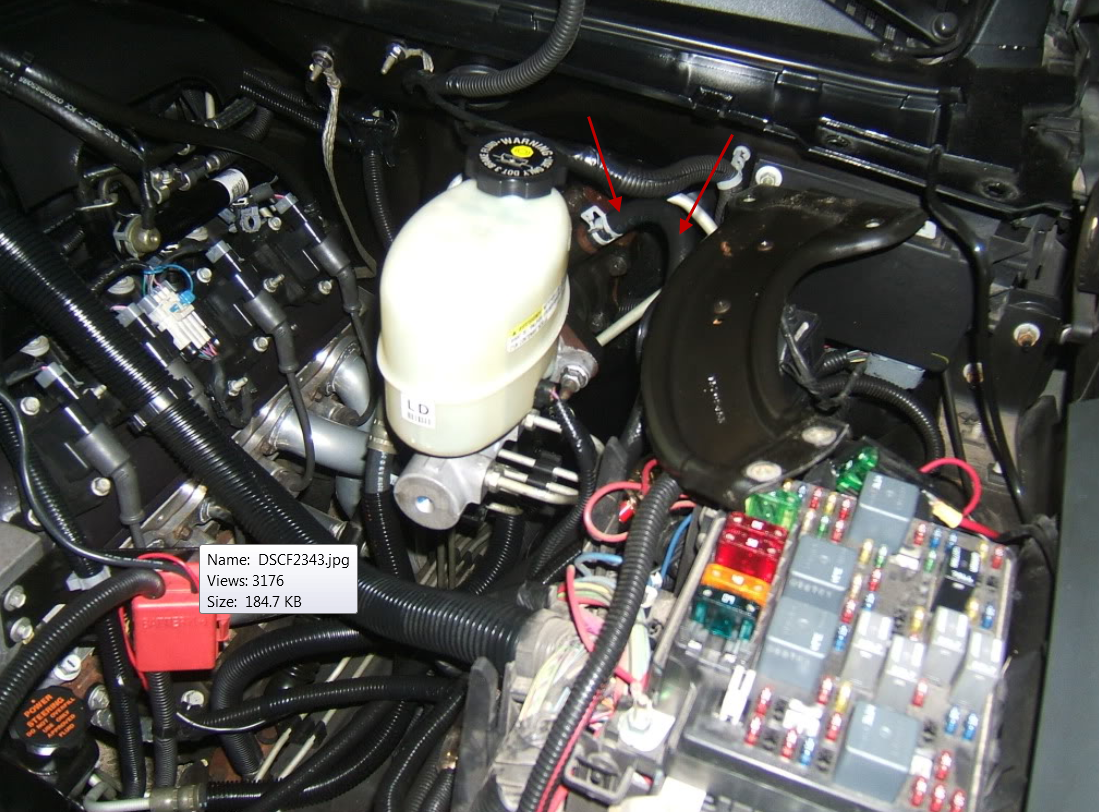

Can someone please tell me where this hose is supposed to go.

Return back to the PS pump reservoir. If you don't have a hydroboost pump, it will tee into the return from the steering rack.

Went to start my truck up today and brakes felt mushy, pump started whining adn hydraulic fluid sprayed all over the alternator, causing a small fire. Don't know where it came from, so I'm suspecting that hose.
