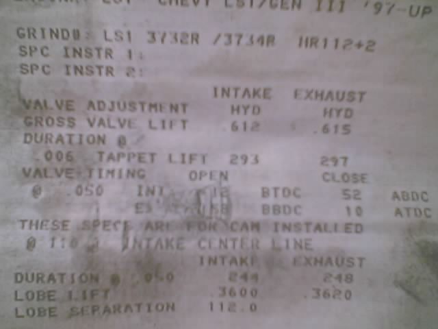

it will provide for a lower DCR with this cam. but also allows for more timing used
Attached Thumbnails Got my 408 back from the machine shop today :)-cam-spec.jpg

Just to be sure i've got this right, that cam with 64cc head, .054 gasket with 4.060 bore (GM mls), about .004 out of the hole, and an 8cc dish would give me a DCR of about 8.0 right? If so, im definetly going to be ordering it.
not sure but that sounds close to where mine sits at
