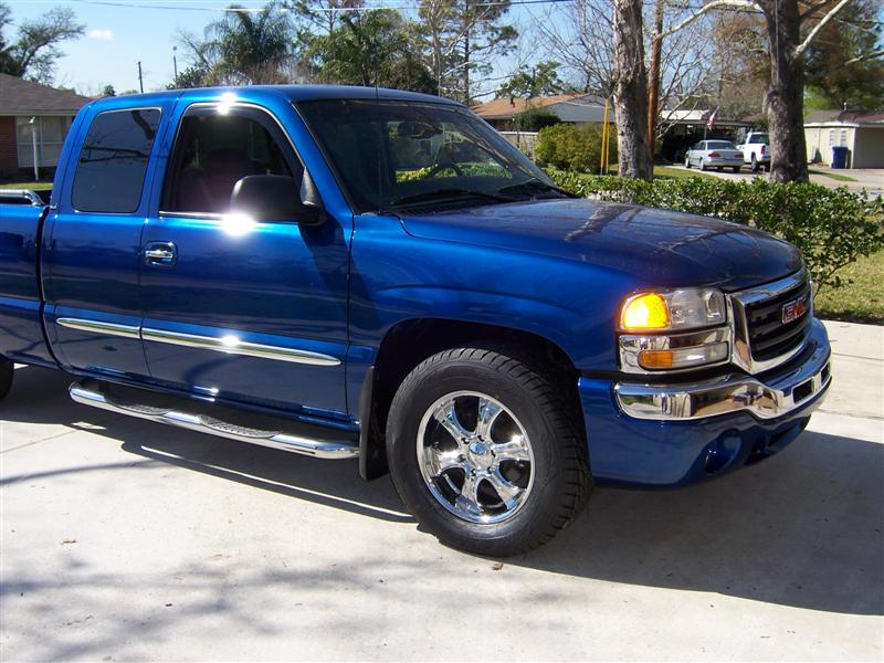

heres some 18's

I think 18"s look great and don't sacrifice too much performance. 18's will also allow most brake kits to fit. Mine are 17" but if I was to do it again I'd go for the 18's.
