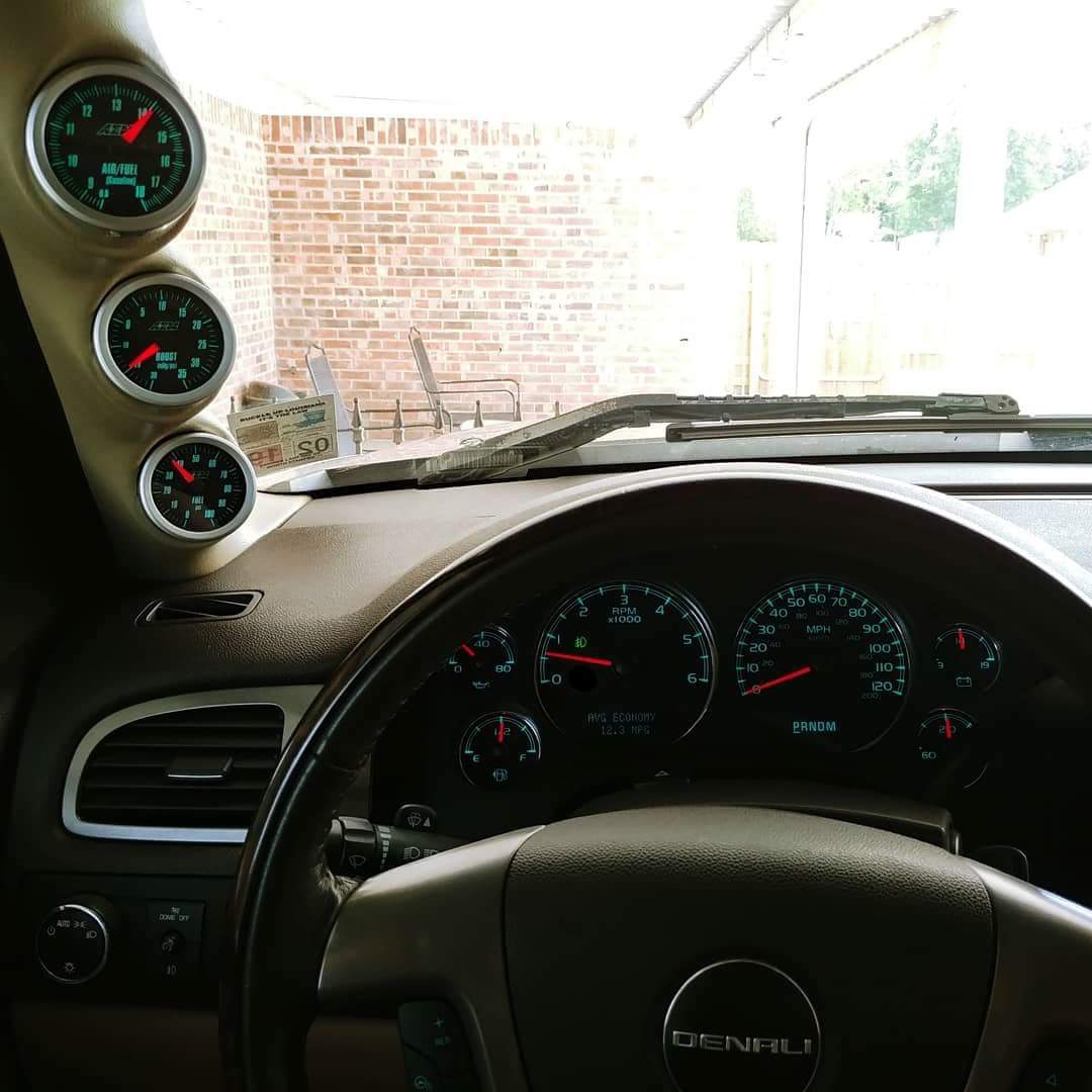

All AEM and look OEM
Edit: just realized it not the correct body style but you get the point. Doesn't affect my visibility but was distracting at first

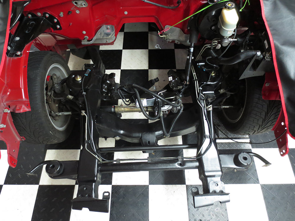

Thanks but a little to late
The plastic tiles clean up really easily with oil or trans fluid spills. The only thing that has stained the white tiles is brake dust when doing brake jobs. I have some extras to change out when they get damaged or stained.

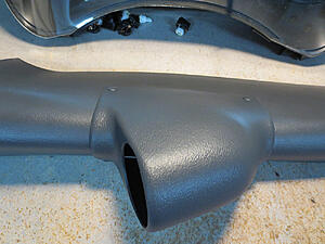

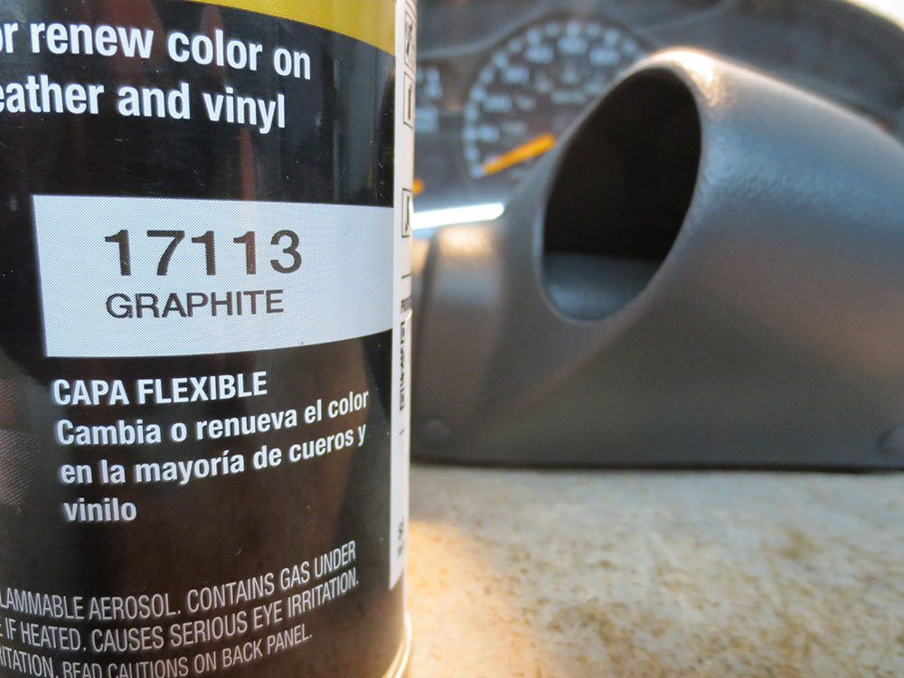

Just a heads up... the SEM 17113 Graphite is a perfect match for my 2000 Sierra interior.
Washed the pod with prep-sol then scuffed with a scotch-brite pad. Washed the pod again (these parts have a release agent during manufacture that can cause fisheyes) with prep-sol. Masked off the exposed OEM A-Pillar then shot one very lite coat. Let it flash 10 minutes then followed with another lite coat. Let it flash 10 minutes then followed by a medium coat. Let flash 15 minutes then followed with a medium-wet coat.
Perfect match as I did not spray any of the OEM pillar
