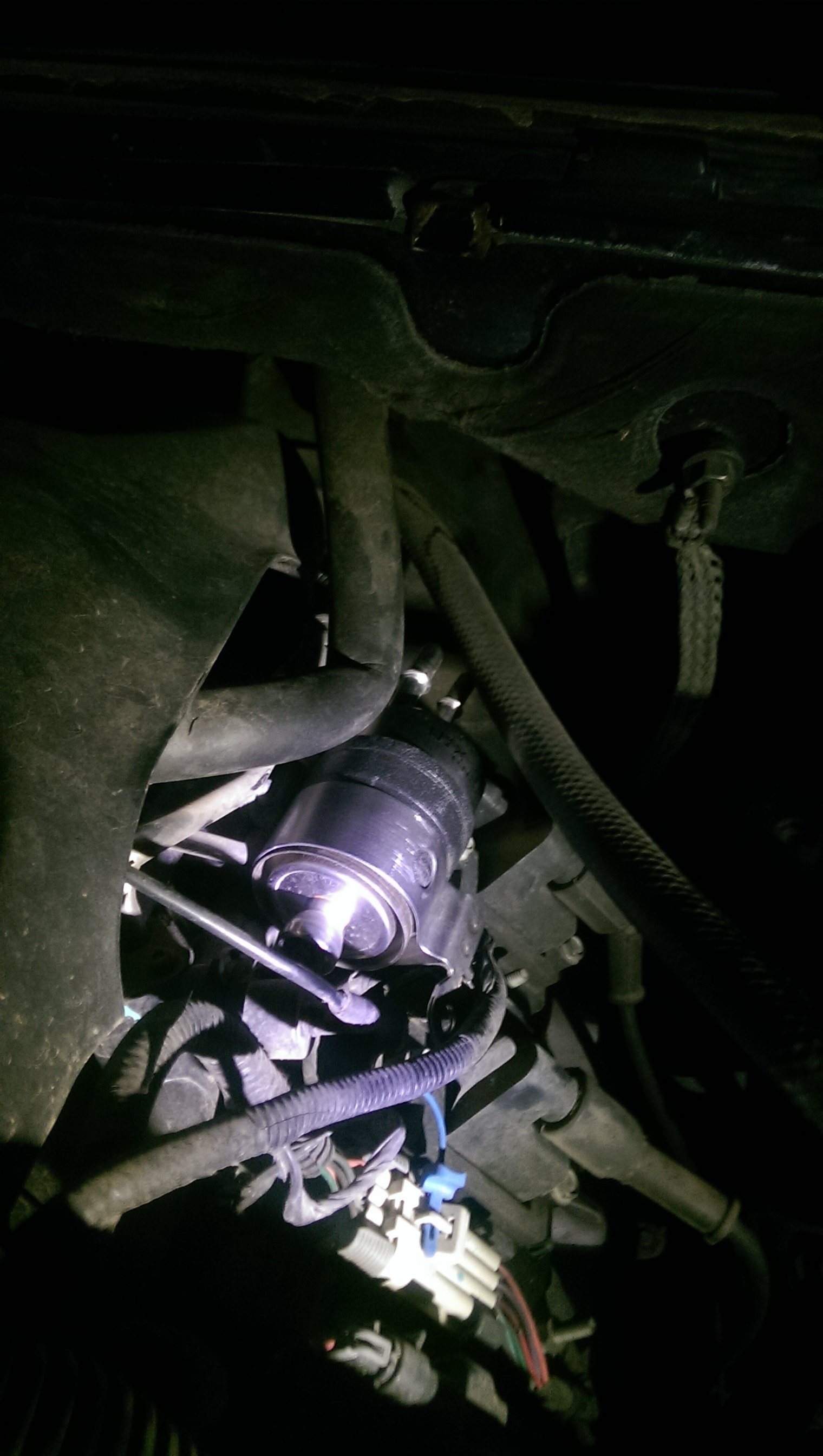

See where the filter is in this pic but instead actually plugged into the lines and the rail on a nnbs manifold. That's where I have it pluplugged in sorry i dont have any pics of it actually on the truck

I cant see the picture, but do you have it connected backwards?
You can move to aftermarket rails and regulator but it will take some work for it to all fit together.
