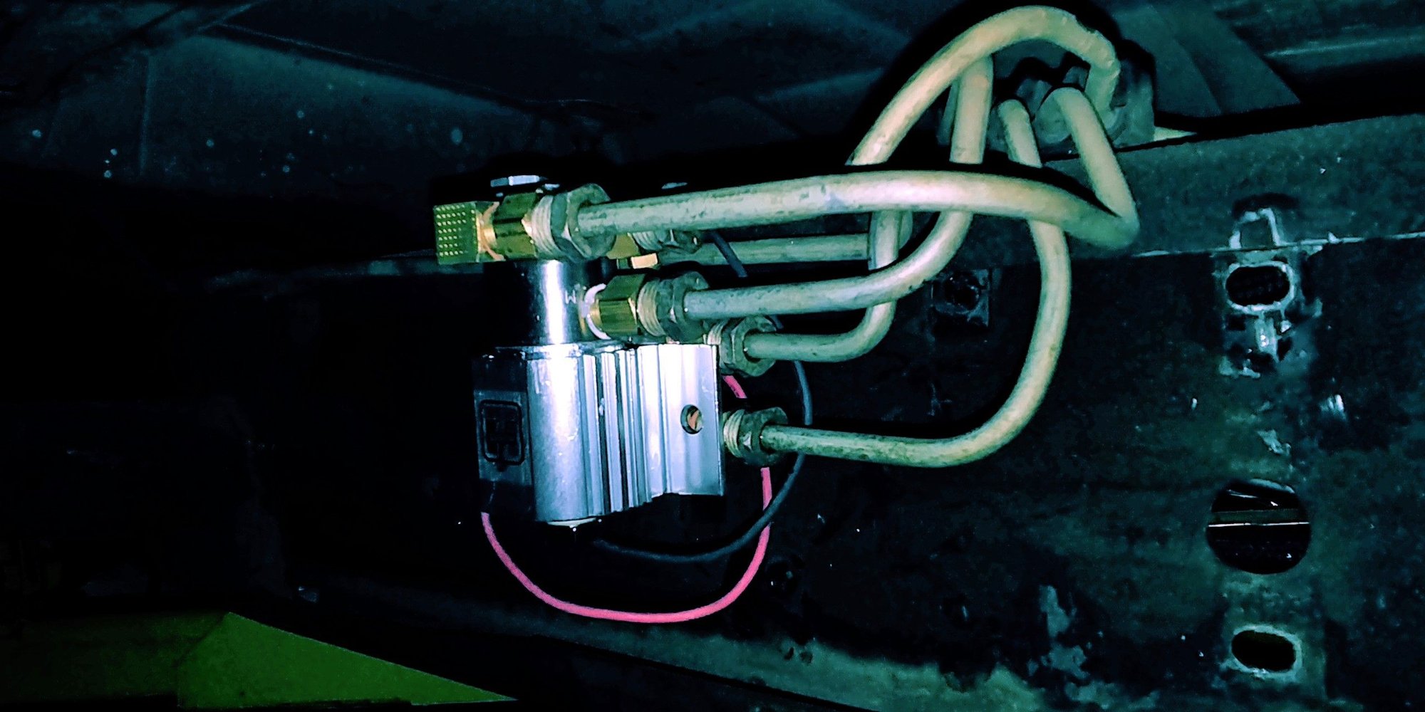

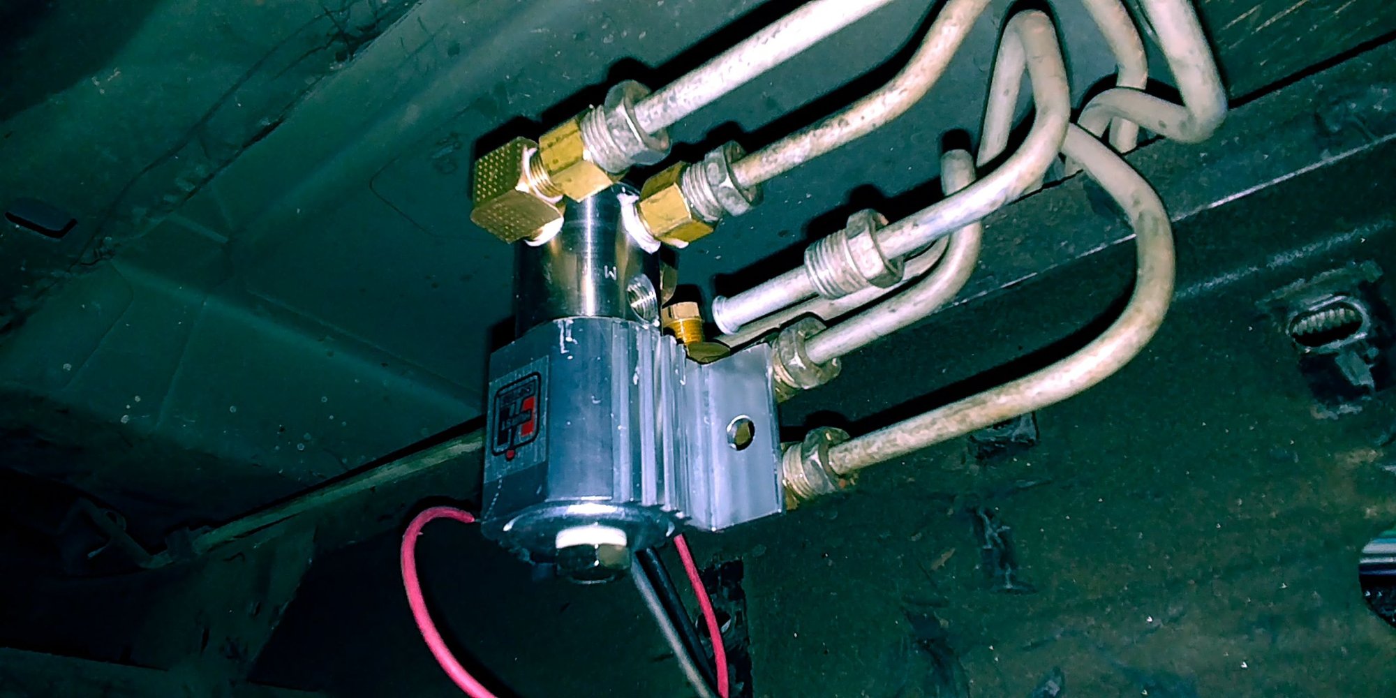

I found this thread very helpful in sourcing the parts. I put my own spin on it though. Used a Hurst Roll Control solenoid instead of the second tee for the front brakes

Hey sorry to bring this back from the dead but am trying to this on my silverado but you never mentioned the postion of the way the lines go?
Old Oct 25, 2023 | 11:43 PM
  #50
silentbravo's Avatar
5 Year Member
Joined: Mar 2018
Posts: 430
Likes: 128
Look at the pictures on the first post, it shows how they go.
