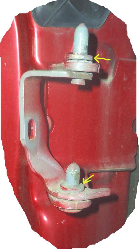

Well guys- took a stab at the door the other night and got ina little further than I bargained for; gee- why does this always seem to happen? Anyhow, I ended up with the dorr totally offso I took the opportunity to more closely inspect how the pin is secured. snapped this pic of the upper hinge pass side- do I hafta dremel off that washer that's around the pin(s). Seeming that there are 2 pins per hinge can all 4, upper and lower 2 be replaced? There where only 2 replacement pins in the kit..........

Anyone, I'd like to avoid getting in over my head on something. On a lighter note, got some new tires yesterday and, whoa what a difference! The little imperfections and bumps in the road are just that now, not the percieved bottoming out affair as B4. Stops better and doesn't float all over like it did. I can only think what the last tires must have been subjected to.........
