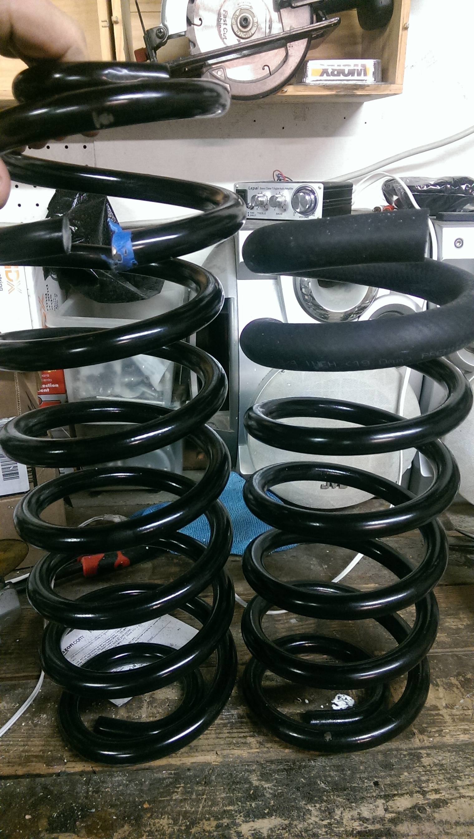

Im running cut z71 springs on my Nali xl, which is heavier. Took off two coils. sits @ 35" height from the street to the fender lip in the rear. I used 3/4" heater hose instead of spring isolators.
You can see how much I cut:

You can, but you totally screw the spring progression when doing so.

truth
My Moog coils did not appear to be progressive. OEM may be. My Ride isn't terrible.
Needs the free travel mod though.

If you keep the spring cold while cutting, you won't mess up the spring rate as bad. Spring steel hates heat
Well yeah... don't use a plasma torch. I slowly cut em with a grinder and oil.
Old Jul 7, 2016 | 07:11 PM
druff's Avatar
Joined: Jul 2016
Posts: 46
You'd be surprised how many people take torches to them. And I'd go slower than that, I'd go hacksaw
