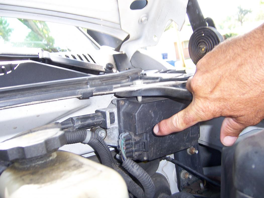

I DID IT ON MY 01 TRUCK. You need to buy cruise control servo (EBAY $50) AND BLINKER SWITCH OR CHANGE STEERING COLUMN.
I included pic of servo and wire is already there under hood,just take cover off.
