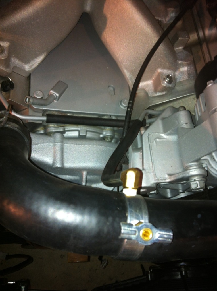

What is everyone doing with the front crossover when using a non coolant throttle body?

From: Humble Texas

If you are not running a S10 conversion with a barb in your upper radiator hose... just run the crossover to the nipple on the pass side radiator tank with a piece of 3/8 hose.
