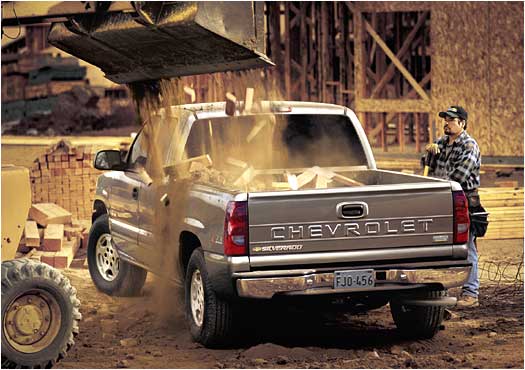

Looking for anyone who has one or knowledge of one.
1) Would one of these Pro-Tec tailgates fit on a standard steel bed?
2) What is the difference in the two types that I have seen:
a) one has molded lines above and below the CHEVROLET emboss
b) one has only the embossed CHEVROLET.

As far as I know, they are 100% interchangeable. I've only ever seen the ones with the raised CHEVROLET letters. If there are ones without, I'd guess they were used on GMC trucks.

But I'm not looking into this for a weight savings and I know it won't be cheap.
I really want to know why there are two different types and if they can be swapped over:

The one with the ridges looks to be on an 03, the plain one looks to be on an 01-02 so maybe that is the only difference since there was a slight body style change in 03.
Either way, there were no bed changes between those years so I don't see why they wouldn't be interchangable.
