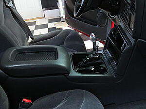

You need the console itself, the 15118821 bracket posted above, the glove box surrounding molding and the bezel that goes under the steering column. Those two last pieces are shorter than the non console pieces and fit up next to the console. You can cut to fit the non console glove box surround and knee bolster (bezel) on the drivers side but it may or may not fit well.
To get a tight fit to the bottom of the dash... pull the console up until it bottoms on the dash then tighten the two slotted 10mm bolts on the 15118821 bracket.
