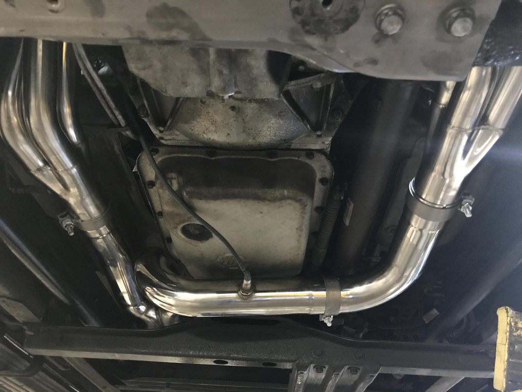

No cats, WB sensor is in the H-pipe (see pic below) of the Speed-Engineering True Dual H pipe. Given its placement I have to think it's biased to the driver's side bank but at least it's there:

im not liking that wideband location and the o2's are suppose to be mounted on an angle minimum 10 degrees up from 90* that looks like its right at 90 degrees plus if your burban has any rake to it then it might be under 90* and that will cause a problem condensation

I also had that same thought standing under the truck. Going to ask the Speed Engineering guys about that...

Eh, it'll be fine. I ran a wideband in my old grand prix for 3-4 years with it a straight into the side of a exhaust pipe like that.
There really isn't a "great" place for the wideband bung on the SE headers unless you welded it directly next to the other o2 sensor.
