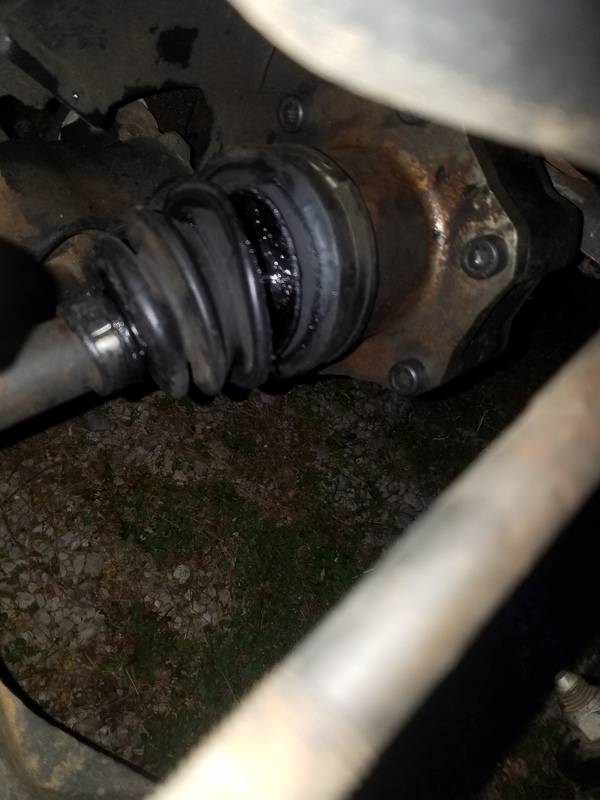

Ok so i put the truck on jack stand and let in run in 4wd...i had it secured.
at idle all 4 tires moved freely. the front right was moving faster than the rear it looked like...but both rears were spinn. so when i put my boot on one of the rears to slow it down the other side sped up to what it looks like matched the front until the rear locked. aftwr i sit the truck back down i noticed this.
this passenger axle is broke...and i noticed that the truck idling along trys to pull thr steering to the right when it starts to bind...could a broken axle cause this problem...who wants to bet.
gonna replace it tomorrow ince i have to anyways
