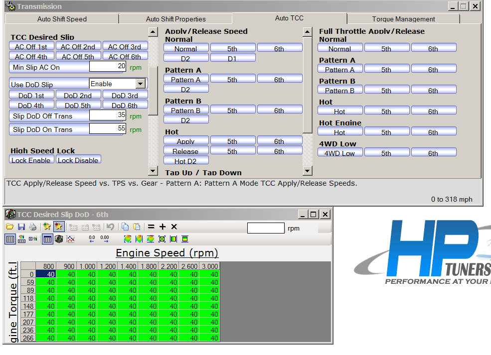

So lower gearing gives better mpg. I think too if GM had tuned the trucks where they shift at a lower mph like the Corvette it would help too. At light throttle shift mph is less with my Corvette and it's geared taller.
I think why I have not notice my truck having DOD is all the converter slippage. This chart shows how much. Pulled up 6th as an example but all gears are 40 rpm slippage.
