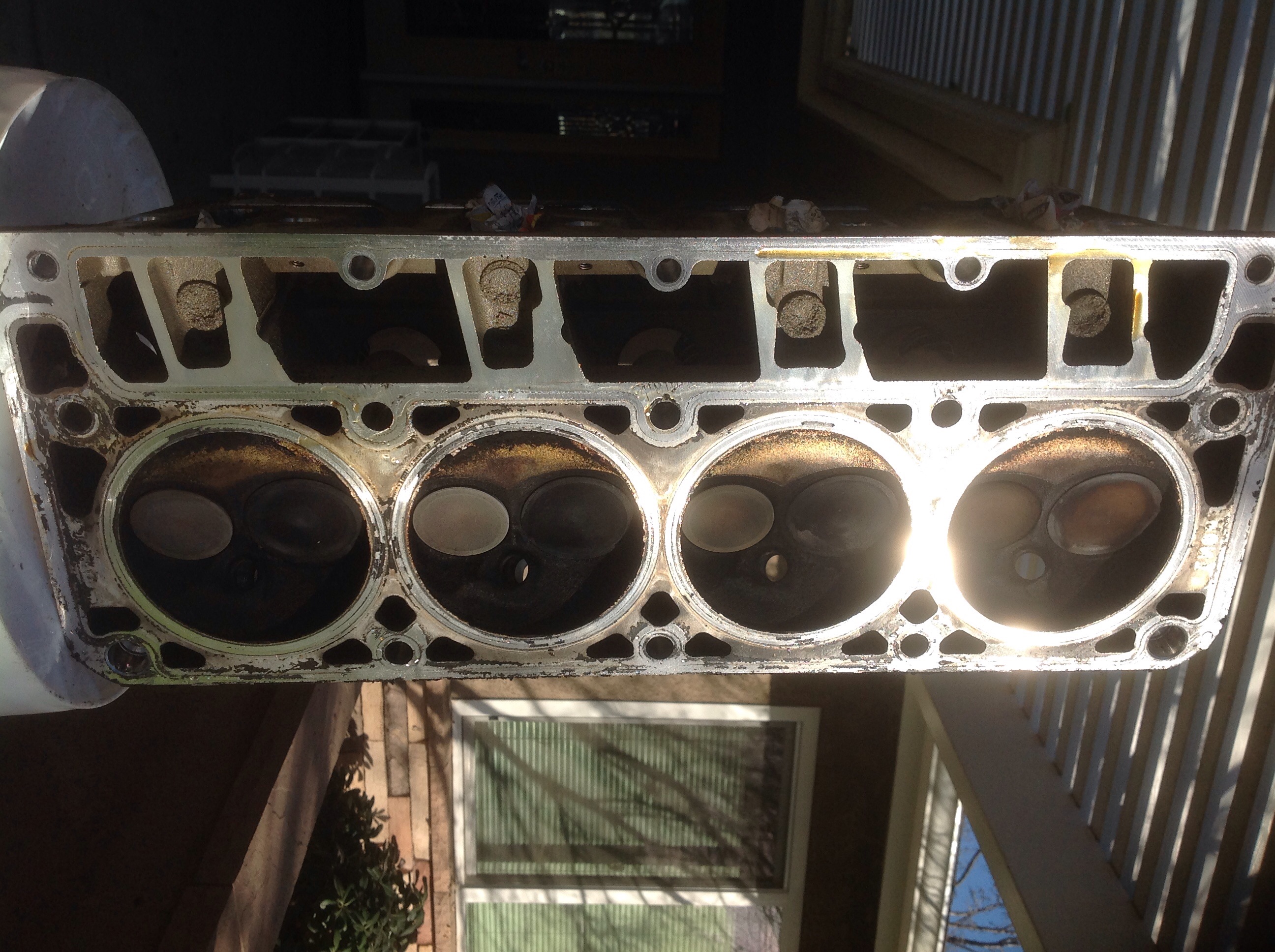

Made time today to get the engine torn down. Was throwing a misfire code/CEL. I was unable to determine the issue, leak down test pointed to a burned valve but I don't see any signs of that. Could an intake leak cause this, although all bolts were tight and no obvious streaking of gasket. Plenty of tar inside the intake and ports.

A misfire is either lack of fuel, lack of spark, or lack of compression.
It could be plugs, wires, injector, wiring issue, bad ECU, Bad 02 Sensor's, bad MAF sensor, Bad fuel, Weak or broken spring, bad valve, Build up in seat area on the valve, The list goes on and on.....
The one on the right doesn't look like right based on the burn pattern around the valve compared to the other cylinders.
