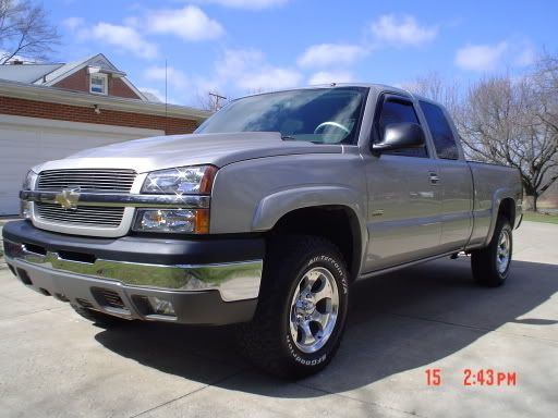

Heres an old pic of my 04, had an STS turbo and cam , i liked that truck.

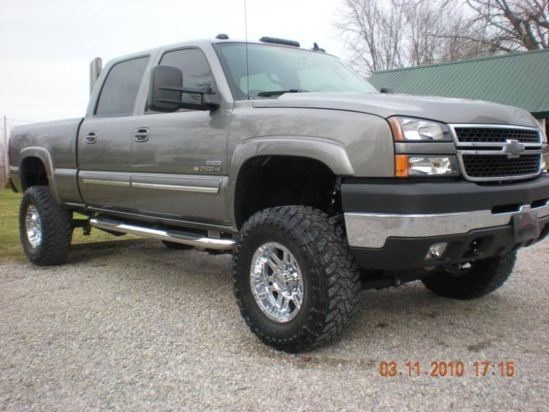

Heres my old 07 Dmax, you can see the difference in the two frontends, fenders are the same .
