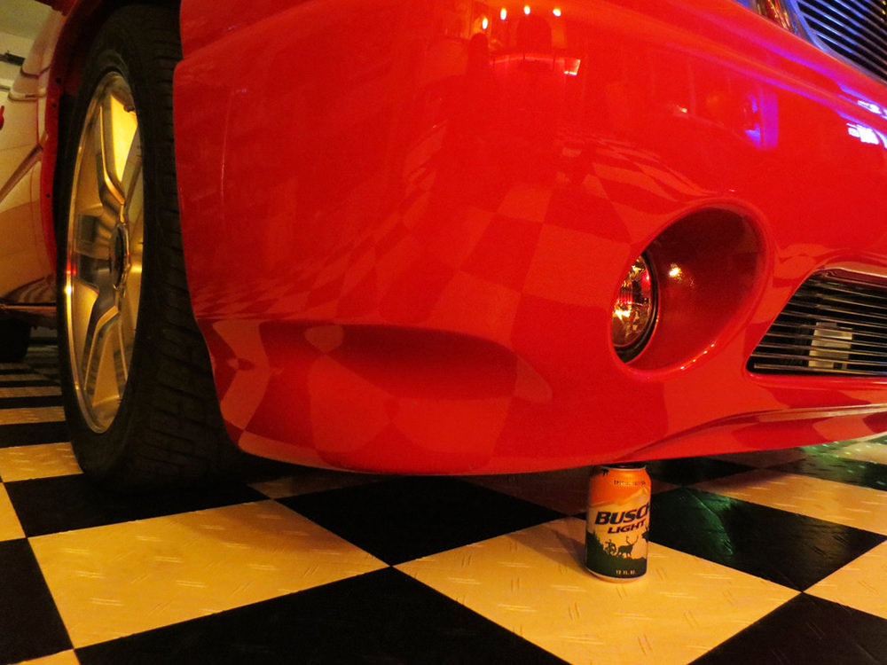

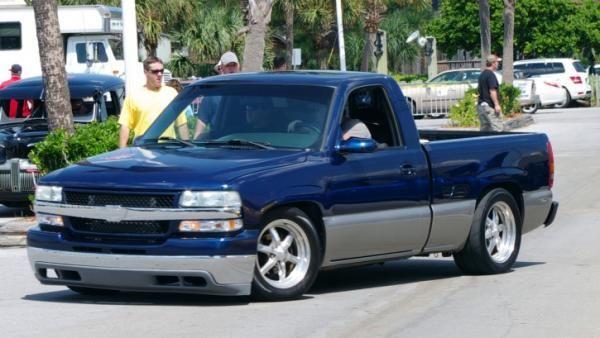

This was with the 2/4 Hotchkis springs (that have sagged to like a 3/5) prior to cutting the brackets and raising the bumper 1/2"....
Now with coilovers/spindle up front (~4") and the bumper raised 1/2", the stock valance barely doesn't clear a standard parking stop/curb.
Your setup looks great.
I've thought about mounting a backup camera up front to monitor those parking stops on the double din flip screen. It's been close to ten years since I did the Denali bumper and haven't hit one yet. Parking on an up hill grade it's harder to judge where the stop is compared to level ground. Uphill I always feel I'm close to the stop but when getting out looking, I'm usually a good distance away lol

3" drop with a 30" tire will clear fine. Not going to get 4" up front with that tire and not rub alot. Front tires in my pics above are 28.5".
Thanks, its currently in the shop for a makeover so stay tuned for a fresh new look.
I would almost prefer it be a little lower so it hits the curbs rather than going over them and catching on the way back. After ripping the valance off a couple times, I got good at either stopping short or backing into a spot with a parking stop. Luckily most of the parking lots around here are pull thru.
