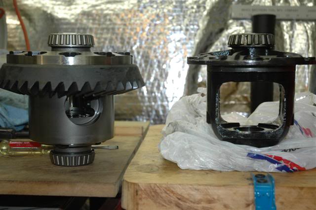

To be more specific, what I was really meaning was the carrier assembly of the rearend, an aftermarket carrier is one that wasn't available from an OEM(Original Equipment Manufacturer). When compared to the stock/PEM carriers, almost every aftermarket carrier is inherently stronger.
Here is a picture of a stock OEM open carrier next to a Detroit Trutrac. Look at all that extra beef. Both are from/for a 10 bolt 8.5/8.6. The OEM G80 locking rear dif is even weaker.

peace
Hog
