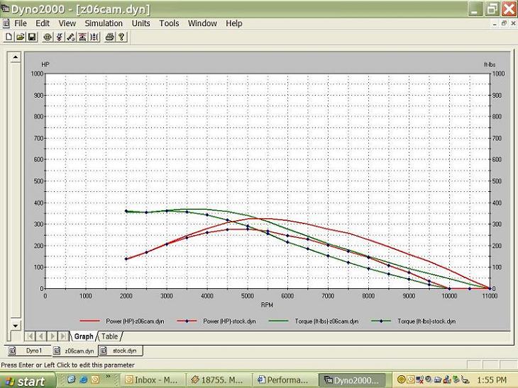

So you don't think there is going to be a terrible loss of low end power? According to desktop dyno (which I look at soley for power curve characteristics and not real numbers) Desktop Dyno shows the comparison between stock motor and stock motor with '01 LS6 cam installed. The curves with the "diamonds" are the stock curves and just simply by adding the cam look what happens. Now I want you all to know I was accurate as Desktop Dyno would let me get while doing this simulation. Compression Ratio, Head flow #'s, exhaust, everything! Here's what it looks like. STOCK is Diamonds once again and regular curves are with the Z06 cam. Does everyone agree that this is an accurate depiction??
Thanks,
Joe

The specs on the 01 LS6 cam are 205/211 @ .050 and .525 lift w/a 116 lobe separation angle. I also hear though that GM grinds -2 deg into this cam. Does this sound right?

Theres not many cams out there that will help with low end TQ on the 4.8 unfortunatly. Do a convertor(for those that were confused- ) and 4.10's and you will see some improvements down low. But I dont think you will be dissapointd with the LS6 cam-supposodly they are pretty fun!

If you have the '01 version of the cam it is very similar to the one I have in my 5.3L, just with a little less lift. I don't see how that would be a bad cam in your truck. On the contrary, I would think it would be decent, even on the low end, if degreed correctly. If you do decide to go for it, I would see about advancing it 4 degrees. If it does in fact have 2 degrees of retard ground in, that would mean advancing it 6 degrees.

Exactly Naked AV, this is why I don't get why people bitch so much about the '01 LS6 cam. I think they get it confused with the '02 & up. I got a cam recommendation from cammotion awhile back and they wanted to custom grind me a 205/210 dur @.050 .550/.544 cam with 114 lobe deg separation cam. The '01 LS6 cam is not far off from that 205/211 @ .525 lift on a 116 lobe deg separation. I can't see how this cam is going to be that different than the one cammotion recommended. Also, I don't really have the money for an adjustable timing chain set, How many ft lbs increase are we talking from 2000-4000 rpm's by advancing the timing chain 6 deg? 10 ft lbs or so? Is it even noticeable? I want to know if this is a dumb project I'm about to dig my hands into or if this is worthwhile?
Joe
