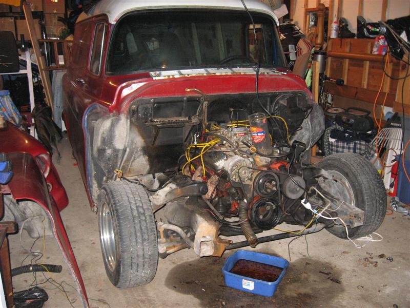

I actual have an 4l60 not the 4l60e -- I don't think it will need the ecm . the old early 90's 350 that was org in the truck didn't have one and as far as I can tell from my tear down can find one for the trans either .
or am I completely off base on this ?
thanks for teh welcome ! I am also trying to figure what is the best cam /spring combo .. you know in case I can scrape up an extra grand for more power
here are current pics
Attached Thumbnails will this work ?-panel_drive-medium-.jpg   will this work ?-porsche-094-medium-.jpg   will this work ?-porsche-068-medium-.jpg   will this work ?-porsche-070-medium-.jpg
