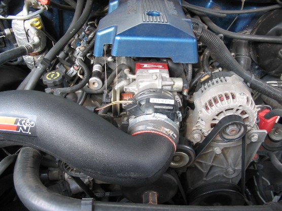

Originally Posted by Snake Eater
Parish, like BigTex said, the MAF reads pretty well. I had trouble at first with my dry shot being so big it was freezing the MAF. I relocated it to the TB so the NOS had more time to expand before hitting it.
Here's the pic. Sorry it took me so long.

How did you attach you tube to the filter once you moved the meter to the tb on the GenII? Got a pic of that?

BigKID, I actualy went down to home depot for ideas and ended up with one of those dryer vents . The one that goes through the wall. It had a 4" tube and a flat end perfect for cutting to match the filter mount. It costed about $5 and took about 20 minutes. In all it fixed my problem I was having with the dry shot. I dont have any pics right now of it. My truck is 6000 miles away . But ill see if i have any on my computer already i can zoom in on.
