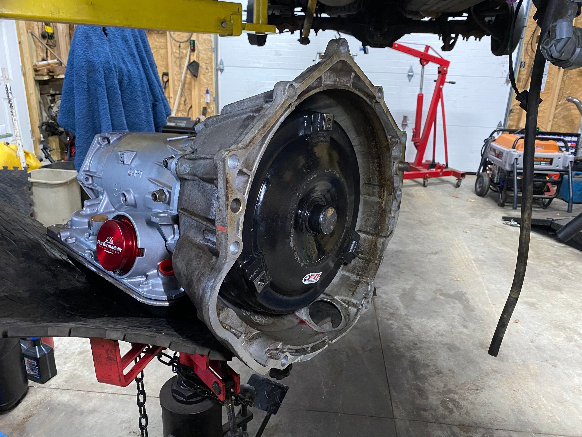

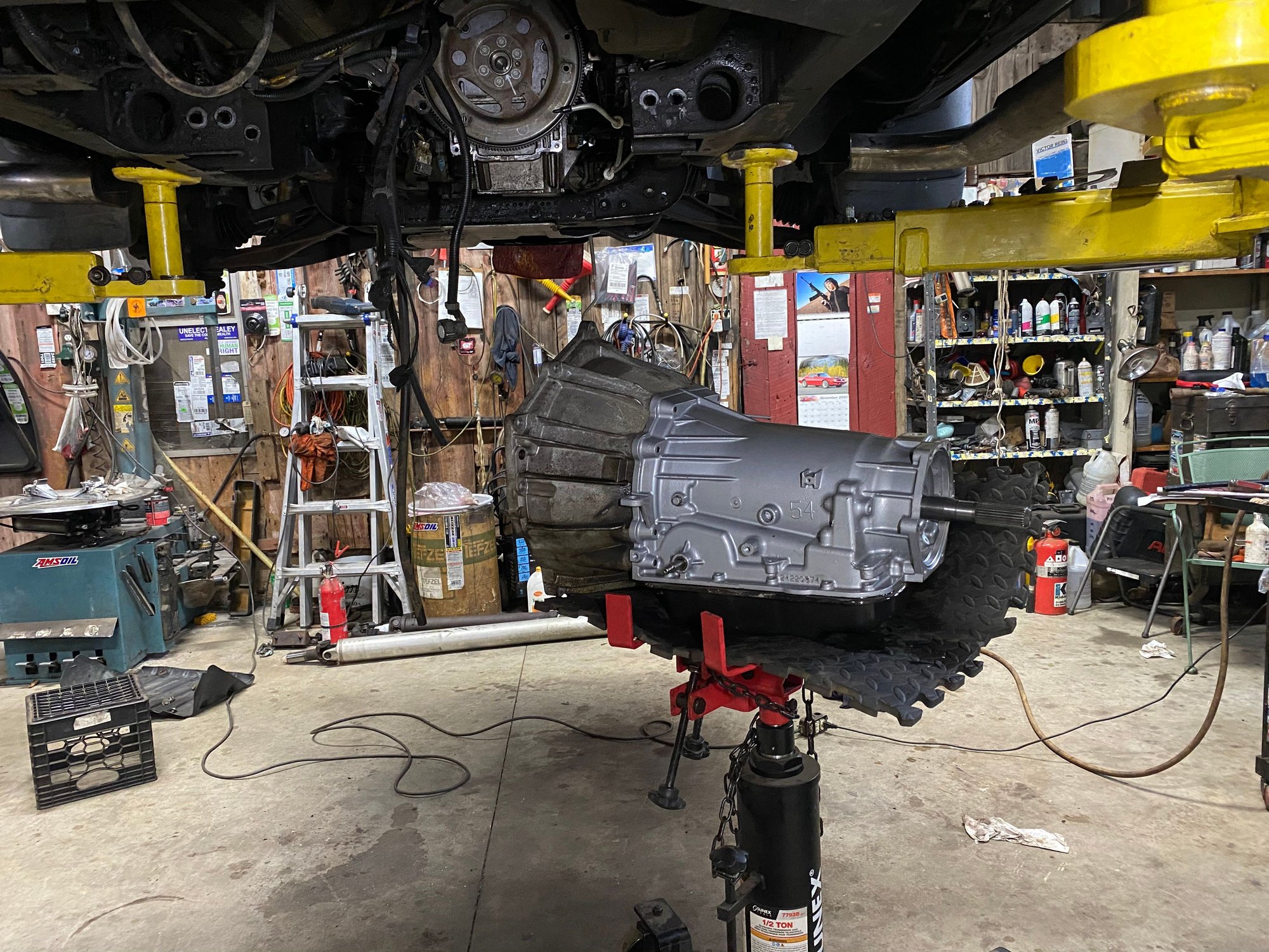

Already done, as I mentioned. It failed at 103k miles. One of the reasons why I don't trust my engine, since nothing on this truck has been trustworthy. Rear end failed at 97k. Tips of the spider gear teeth were all in the magnet!

Stuff was still good in '03. I see plenty GMT-800 series trucks well over 300k miles still driving and coming into my shop around here. The 900 series seems to be plagued with low oil pressure and piston ring tension issues, and most have to be opened up not long after 100k miles for top end work (Lifters and cam, usually, along with valve springs, and VLOM issues). Look at my transmission for example - I've seen plenty 800 series trucks with over 200k on the stock trans WITH abuse. Mine was worked, but I run the best ATF I could buy, and it STILL smoked 3 & 4 at 103k miles. My '94 K1500 had 266k miles on what I believe was the stock 4L60E, and I towed with that thing every bit as much as with this one. Plus I was younger, and my foot was A LOT heavier.
