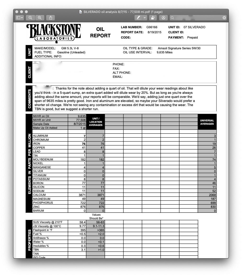

I don't think my oil burning issue is AFM related. It only happens at high load, high RPM - that to me screams piston rings. Also backing that up is an early oil analysis I had done when I felt major changes in the running characteristics happening back around 77k miles - real high levels of iron and aluminum (rings / cylinder and piston). This got MUCH better with a switch to 10w-30 from 5w-30 and a shorter run time:

If no additional cyllnder or piston damage as a result of the oil consumption (which is unlikely), have new rings (properly gapped for supercharging) installed along with new cam bearings while you're in there and some ARP rod bolts. Then do your AFM delete new timing chain and pump, which was hopefully already part of the plan. Should last another 122k on 6 psi.
