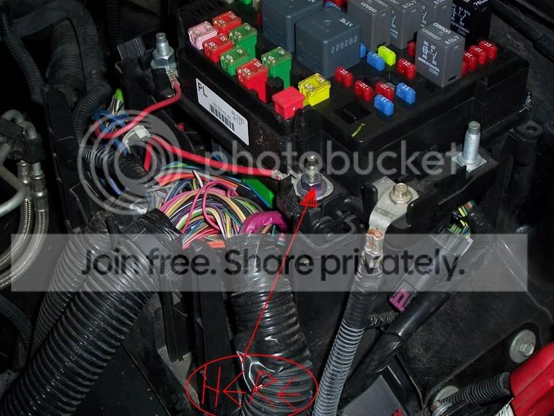

what does this wire power

anyone know right off hand?

Stud #1 is "Auxiliary Power" on my Av. Varies with vehicle content. Service Manual says to check your Owners Manual.

if you swap out that fake fuse for a 40 amp then you will have power to you trailer brakes.
