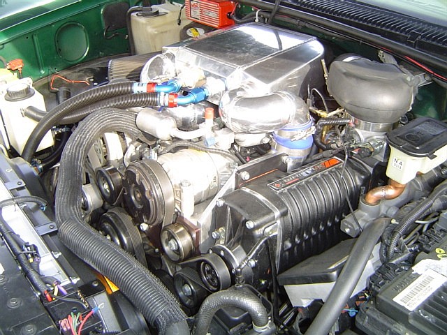

Call up Flex-A-Lite and tell them you want part number 33057.
This VSC has heavy-guage wire soldered in to splice to rather than the lug terminals. It handles greater power. This VSC is superior to anyone's fan harness because of the soft-start and variable RPM features.
The reason the stardard VSC fails is from the heat created by poor connection between the terminals and lugs of the four main power leads. Vibration causes the lugs to spread out and lose conductivity in the connection point which causes resistance and generates enough heat to actually melt the solder on the circuit board within. This happens all the time to many people unfortunately. The only way to prevent it is to zip-tie the wires down tight so they cannot vibrate on the connectors. Once the damage is done though, they cannot be fixed. I am not trying to make excuses for Flex-a-Lite, I know this sucks and the instructions make no mention of how critical it is to secure these main power wires. I can tell you for a fact that vibration is the main cause of VSC failure. The other cause is corrosion from road salt which also causes resistance and heat in those connections. I still have my original VSC purchased in April 2003. It ran from then until last month powering two fans (5200cfm total) when it was removed in perfect working order and replaced with part number 33057 that came with the new 6000cfm fans.
The original VSC electronics are not too small to control two fans, despite popular belief. The flaw is in the terminal connections' ability to maintain a good conductivity and handle the power, not the electronics.
Part number 33057 is visible at the lower left of this photo. The heavy-guage black, red, yellow, and purple wires are soldered on.
