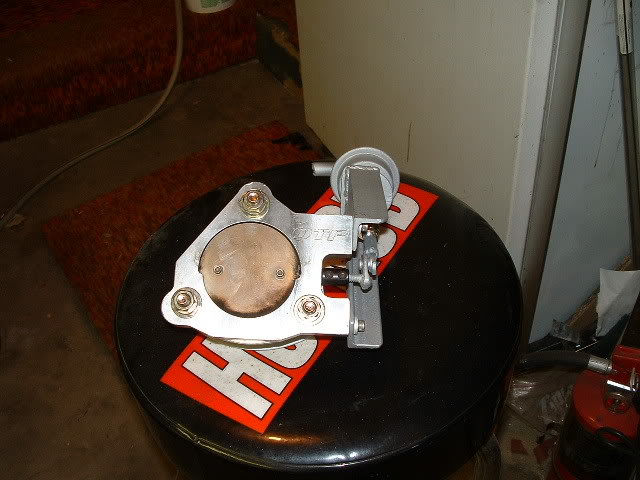

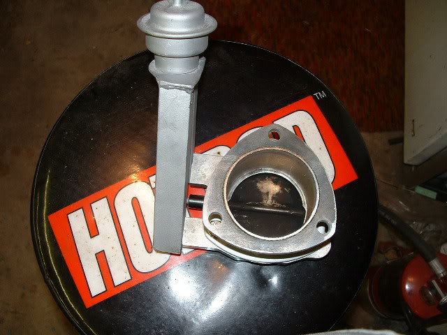

Here is what I built for thunder550.
And a short vid
The extra spring on the shaft is used to adjust it for the boost opening psi. It pushes aginst the spring pulling in the waste gate actuator

I know, I wish I had one on my truck, The QTP cutout part is hard to come by on the cheap though .
