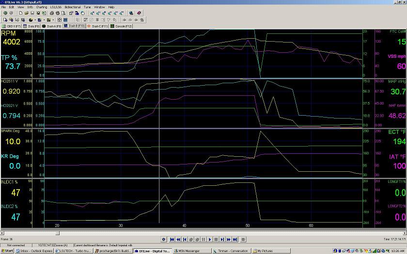

here is a screen shot of one of the runs

You have all the torque management stuff taken out, right? Like max torque set to 639?
Whats your High octane table look like, mainly in the bottom third of the table from idle to redline? I know the stock table actually drops to zero and below zero when you really start pushing air.
Do you have the Knock learn disabled so it doesn't look in the low octane table?
Also look in IAT vs load and make sure its not pulling too much timing for your IAT's.
Got the Edit file you sent me, and judging by this screen shot, your IAT's go from 100-150 degrees during the run. Your edit tune pulls 7 degrees at 100F, and 15 degrees at 150F.
Get that Intercooler tank on there, and get those IAT's in the 80-100 degree range, and you should see 5-11 degrees more timing through your whole rpm range.
Other than that, your tune looks good. Its just pulling timing because of the high IAT's.

Thought i might have something to do with it
whay Table are you looking at to see those numbers?
IATvsLoad table. That table is in Celcius, so you have to convert it.
