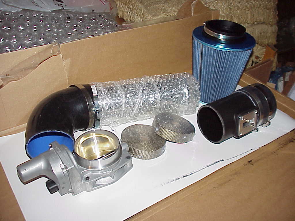

I have the LS3 T/B from a Camaro on my
truck manif, 2011 6.2 fit no prob, works great.
